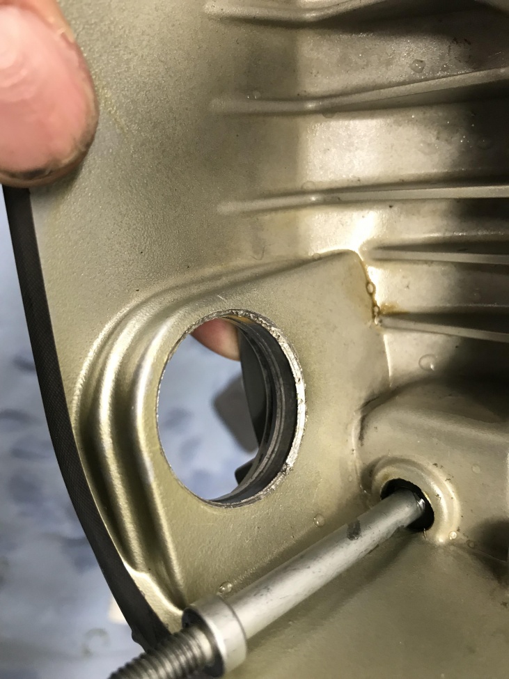

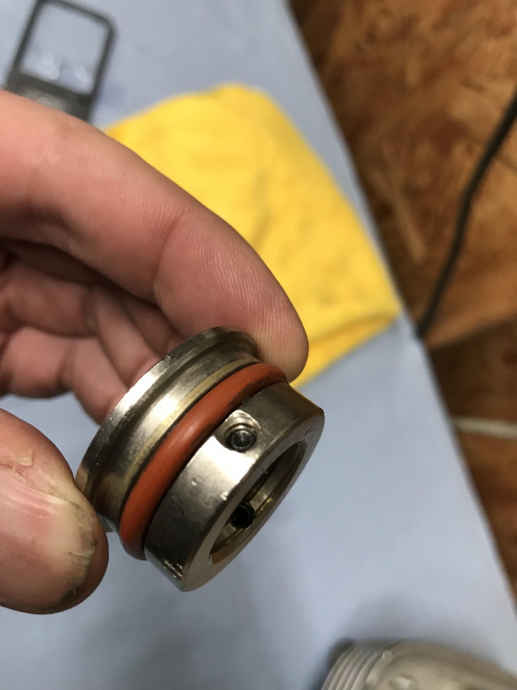

    So I made an #oops.
    The BMW factory filler plug leaks like a sieve so I replaced it with a billet one similar but not exactly like this one:
    Sadly, using the factory wrench it was far too easy to over-tighten the filler plug. What I did not realize is that each time I tightened it the set screws were slowly digging their way into the metal.
    On this last West Virginia mapping trip in the very cold, it finally let go completely allowing the sleeve to spin freely allowing oil to leak.
    I was convinced that I need to get a new valve cover. On Facebook, RubberChickenreached out and explained that I could just use this gasket maker, set the set screws, and let the assembly cure for 24 hours:
    Link #64785
    7 years ago
    Amazon.com: Three Bond 1207B Gasket Maker 1207B100G: Automotive
    Buy Three Bond 1207B Gasket Maker 1207B100G: Gasket - Amazon.com FREE DELIVERY possible on eligible purchases
    https://www.amazon.com/gp/product/B...
    (affiliate link)
    Then simply apply some silicone lubricant to the seal on the filler cap and carefully screw it in using a small wrench so as to not over-tighten it this time.
